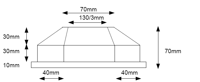

AQS12 Calibration Target Design
The dimensions of the calibration target should be similar to the example shown in the figures below. In any case it should meet the following requirements:
  • The base plane has to contain enough area: The number of pixels on the base plane has to be (significantly) larger than the number of pixels on the roof.
  • Points 1-6 and 7-12 respectively have to lie on the same plane. Base plane and roof have to be parallel. The shape of the object may not be changed, i.e. parallel lines must remain parallel, and the object has to be symmetric.
  • Calibration points 1, 8 and 12 projected to the base plane should lie on a line, same for 4, 9 and 11.
  • In order to get accurate calibration results, the surfaces should be non-specular.
  • The target has to be manufactured from stable (also temperature-stable) material.
  • Check, if the slopes of the calibration target can be acquired under the triangulation angle needed for your application.
  • Be aware that measurements taken far from the target area may have higher errors, as residual errors propagate with an increasing distance to the calibration target. To minimize these errors, it is essential to ensure that the AQS12 target adequately covers the area where measurements will be performed in the future.
  • Due to the symmetry of the AQS12 target, it is highly recommended to attach a small marker to one of the edges on the base plane. This marker helps distinguish between the top and bottom as well as the left and right sides of the target in the range map. The marker can be applied after the target has been manufactured.
The following figures show an example AQS12 with optimal dimensions. It is best to scale it to the dimensions of your current setup.

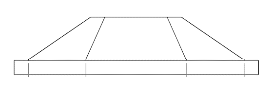

AQS12 Top View
AQS12 Top View
AQS12 Side View
AQS12 Side View
The world coordinates of the reference points for the example shown in the figure above are listed in the following table:

It is worth noting that the vertical walls of the calibration target are not mandatory. The target can also consist of just the base and top planes with six faces (see the figure below):
AQS12 Target without Walls
