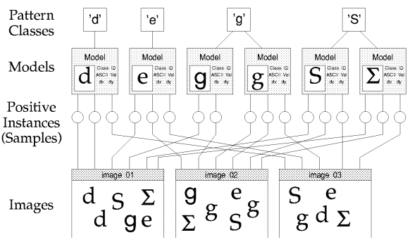

The Training Database (*.mts) always contains:
  • All the Sample Images you add during the learning phase.
    • These images should of course contain samples of the object you want your classifier to be able to recognize later on, but it may also contain an arbitrary number of images that show none of the objects you are interested in.
    • This is still helpful, because these images provide information about what you object's do not look like (in other words: They are evaluated as counter samples for your objects).
  • Information about the "Models" you trained.
    • Models are basically a complete description of the objects you want the classifier to be able to recognize.
    • If, for example, you want to create a classifier for reading number from 0 through 9, you will specify 10 different models, one for each object (character) you want to recognize.
    • The description of a model consists of its name, the anchor point, a feature window size and of course image data that is drawn from one or more instances (that means you can and should provide more than one example image per model!).
    • The models may, but need not differ in their characteristics, which means different models may have different feature window sizes, but different models may also have identical names!

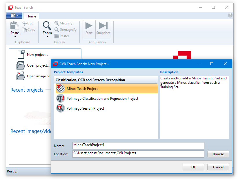

Minos Teach Project
For details refer to Minos Teach Tutorial in %CVB%Tutorial/Minos.
The Teach Bench program is used to teach Minos patterns with the help of example images. Use New Project => Minos Teach Project therefore:
The images which constitute the learning material may either be acquired by means of an external device, e. g. a camera ( vin-driver), opened as an image file (BMP, MIO) or imported via the Windows clipboard.
To create a classifier, you can either learn a simple pattern, for example a component from a production process, or multiple patterns, e.g. the characters of a character set.
