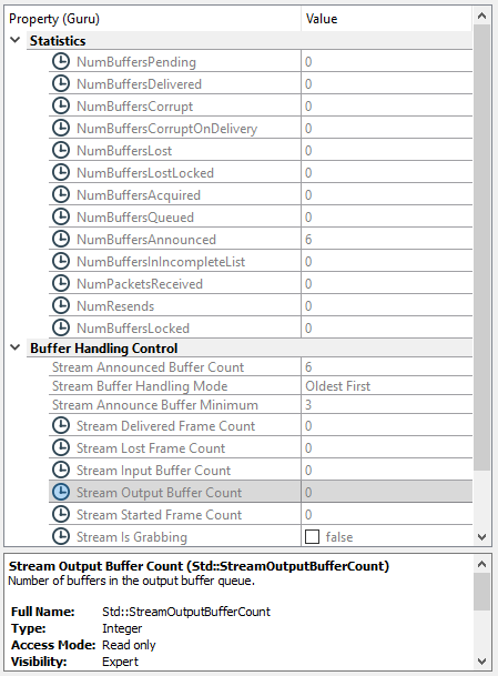

Acquisition Statistics
The data stream node map provides both standard and vendor-specific nodes that offer insights into the acquisition engine. These statistics include buffer states, lost packets, and resend requests in the case of GigE Vision (GEV). Monitoring these values helps diagnose performance issues and optimize data flow within the acquisition pipeline.
