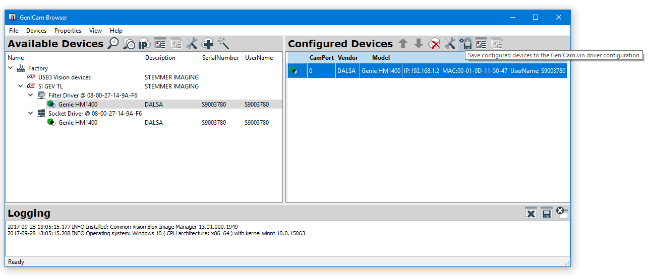

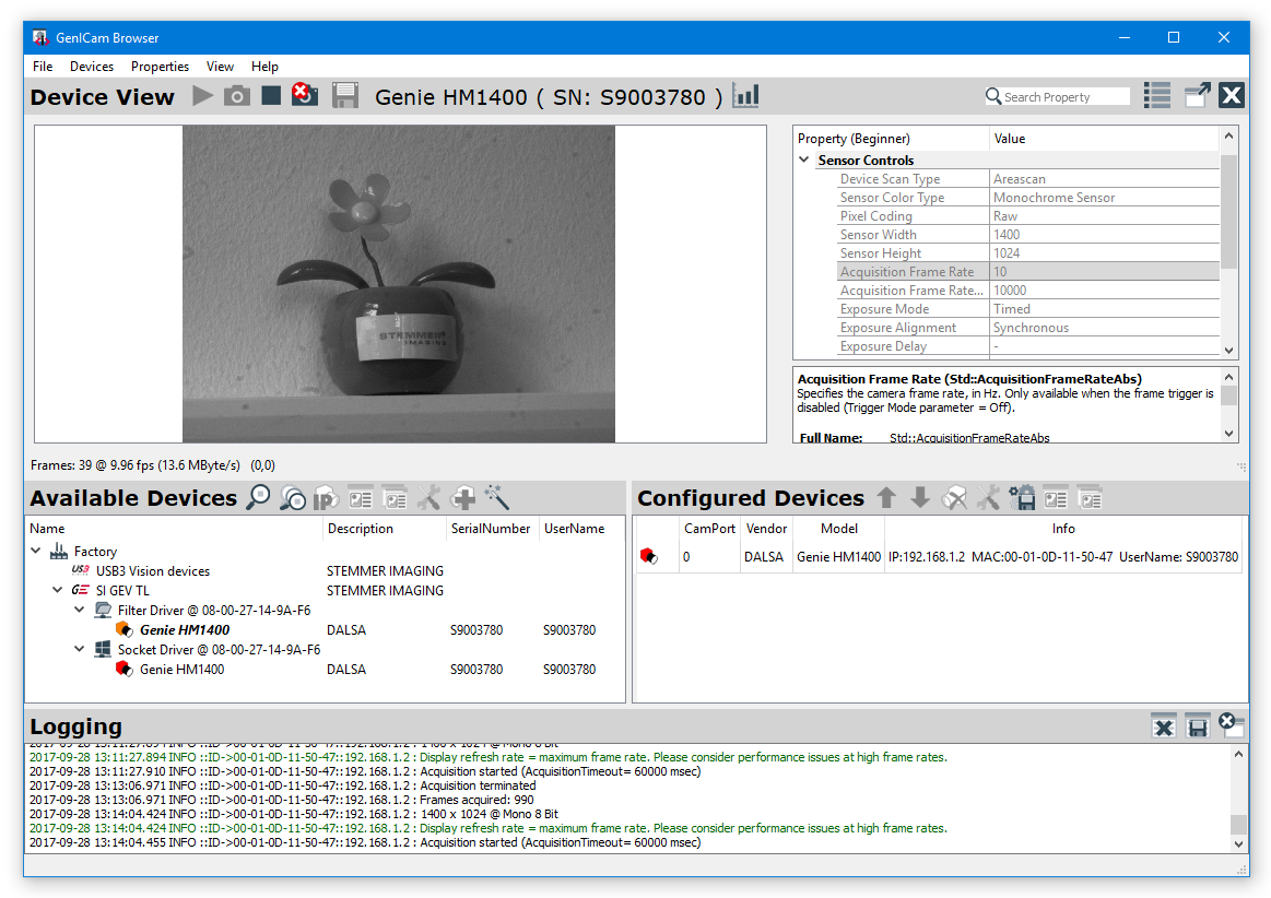

For discovering, configuring and acquisition testing the CVB GenICam Browser can be used. GenICam Browser can also configure the legacy INI file to directly load the GenICam.vin in an application.
The GenICam Browser is available in the CVB installation folder, located at %CVB%Applications

Enumerate or discovery is based on the GenTL interface and is divided into different levels or modules. The first level refers to the different producer implementations available on the system. The second refers to interface (e.g. NIC, USB host controllers or frame grabbers). The third layer refers to devices, and the fourth layer to data streams delivering data. By default, CVB focusses on discovering accessible ready to use devices, but can also be used to discover other module layers. For more details see Device Discover.
Once devices are discovered and opened, they can be configured through the GenApi. CVB presents all camera features as nodes in a tree-structure called node map. This node map is automatically constructed from an XML file provided by the camera. This way CVB can offer safe register access and handle self-describing devices. For aligned access configuration every GenTL module layer offers a node map (XML).

In addition, most often GenTL producers also provide a data stream to fill buffers with acquired payload. In most common cases this data can be interpreted as images. Using the image stream class, CVB automatically interprets the data as an image.
Be aware that device configuration affects the payload types and required buffer sizes. For safety reasons some nodes will be read only when the stream is active. This access handling is done automatically by CVB (see also Acquisition and Streaming).
