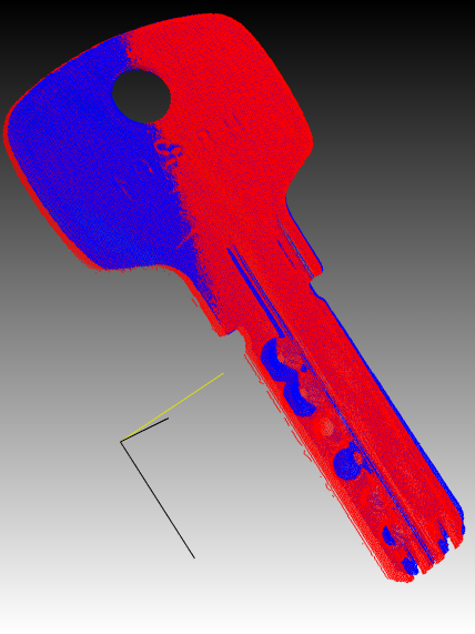

With the function Cvb::Matrix3D::RollPitchYaw the euler angles (roll, pitch, yaw) can be computed from the rotation matrix. In addition, a rough accuracy assessment of the matching results can also be done calculating the RMS with the function Cvb::Match3D::DistanceRMS. However, for the final quality inspection the differences between the model and the transformed point cloud have to be computed. This can be done by re-projecting the point clouds along the z-axis and computing the differences (see section Comparison of two point clouds). The following figures show two point clouds before (top) and after (bottom) the alignment. The blue points represent the model (golden template or reference object) and the red points represent the part to be inspected and aligned.
