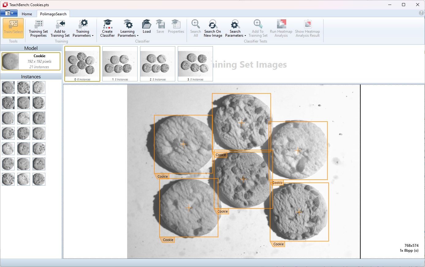

To find a pattern in an image, Polimago searches for this pattern in the image and returns the positions of the patterns found. Before doing so, the pattern must be trained using some example images, which contain this pattern. To simplify the training, no negative examples of the image background need to be given. Polimago extracts these examples itself. Therefore, only positive examples of the pattern to be found need to be trained.
Training of such a Polimago search-classifier is done within the TeachBench as a Polimago Search Project. The following screenshot demonstrates the training set for detecting different kinds of cookies in an image.
Fig.1 - The training set for finding any cookie type contains a "Cookie" class with 21 examples.

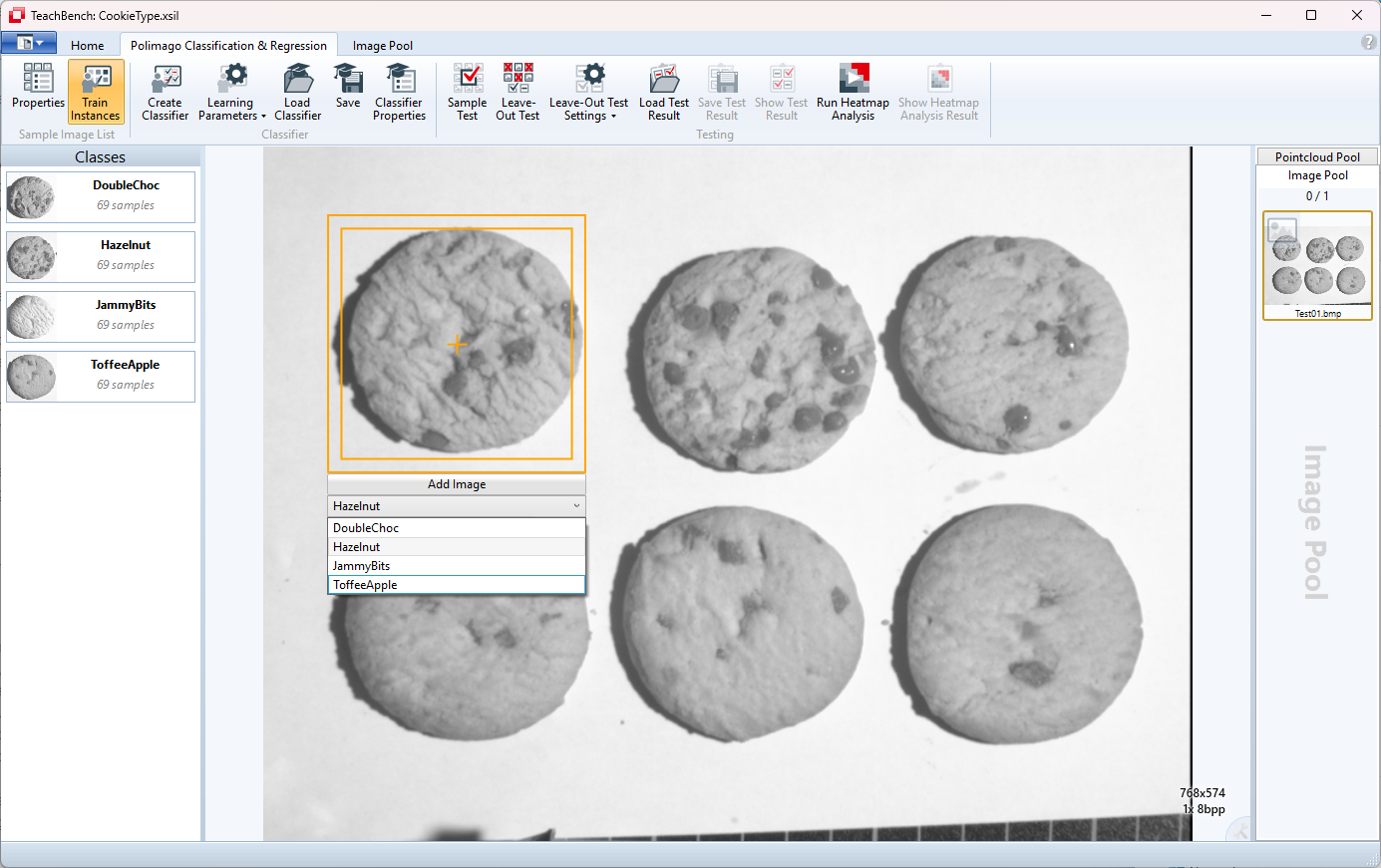

In a second mode, Polimago operates as a classifier to assign one of several classes to a pattern. In this case, the pattern is not searched for in the image, its position is assumed to be known. In this classification mode, class labels can be chosen to be categorial (i.e. strings) or numerical expressions (scalars or vectors). When using numerical class labels, Polimago will assign a numerical value to a pattern via regression, i.e. an intermediate value that comes closest to the previously trained class labels. In the case of categorial class labels, Polimago will assign exactly one of the labels to the pattern.
Training of such a Polimago regression-classifier is done within the TeachBench as a Polimago Classification and Regression Project. The following screenshot shows the training set and a test image for classifing the cookie type.
Fig.2 - The training data for the classification of the cookie type contains four classes with 69 examples each. The test cookie is classified as type "Hazelnut".
