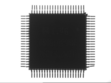

The following code gives an example of how to train the pin of a computer chip. The aim of the example is to find all pins and determine their rotational positions. For training, we select a random pin from the left side of the chip.
The example image.

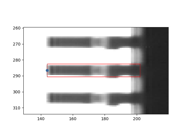

The above python code will produce the following image
Detail of the test image. The blue dot indicates the pattern position, the red rectangle the region.
Using the default settings, the classifier is created with complete rotational invariance and no scale invariance. This can be controlled by setting corresponding minimum and maximum values of the ClassifierFactory object. In this case, the classifier should find all pins, as they vary in their rotational position but not in their scaling.

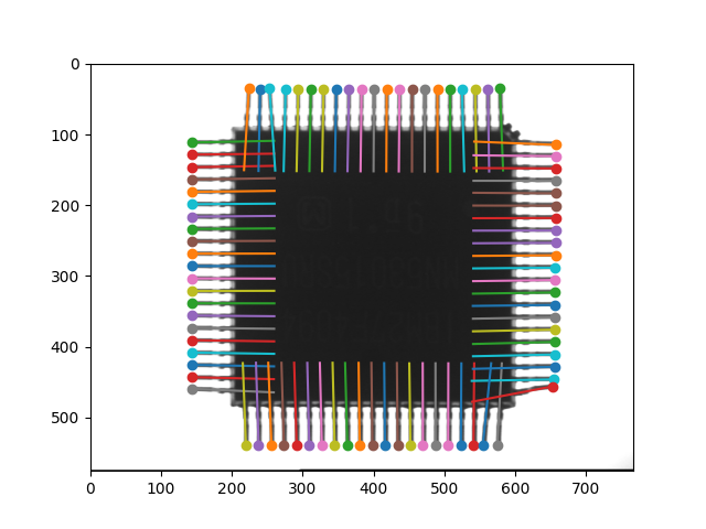

The found pins with their orientations.
