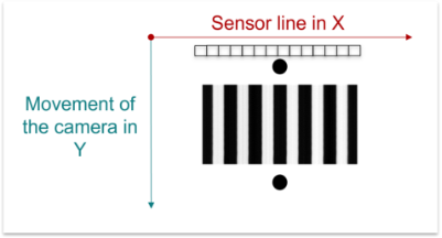

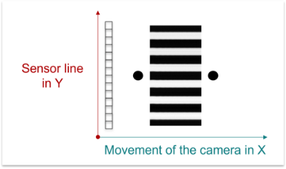

There are two distinct configurations based on whether the scan line of the sensor is stored as a row in the image, spanning all columns (indicating a scan direction along x-axis) or stored as a column, spanning all rows (indicating a scan direction is along y-axis).
ATTENTION: Please note that in some linescan cameras, the user can set the parameter "Scan Direction", which indicates the "direction of movement"! The "Scan Direction" parameter of the algorithm in Common Vision Blox is not related to the "Scan Direction" of the linescan camera.
Scan direction in X
Scan direction in Y

  • The scan direction must be set correctly. It can be along the x- or the y-axis as depicted in the figures above.
