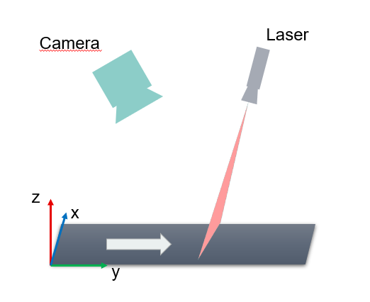

Use Case 1: Modular Setup
Modular Setup
For a modular setup, you will always need an intrinsic calibration to obtain metric x, y and z coordinates. Depending on the required accuracy, you can either perform the ZigZag calibration for high precision or the AQS12 calibration.
An AQS12 calibration is necessary, if any of the following apply:
  • The encoder step is not (precisely) known.
  • The laser plane is not perfectly vertical to the direction of movement (inclined about the X- or Z-axis).
  • You have multiple sensors that need to be transformed into a superordinate coordinate system.
In these cases, you can either perform the AQS12 calibration alone or combine it with the ZigZag calibration if a higher level of accuracy is required.

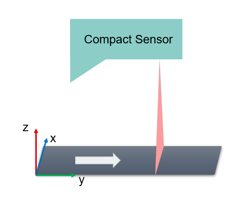

Use Case 2: Compact Sensors with Intrinsic Calibration
Compact Sensor
If you are using compact sensors with a factory calibration (e.g. the AT CS series), a precise intrinsic calibration is already available. If the encoder step is known and the laser is mounted such that the laser plane is perfectly vertical to the direction of movement, no further calibration is needed. You can simply apply the factory calibration. Section Creating a Calibrated Point Cloud with CVB - Intrinsic Calibration details how to create a calibrated point cloud with CVB.
However, if any of the following conditions apply, an additional AQS12 calibration is required:

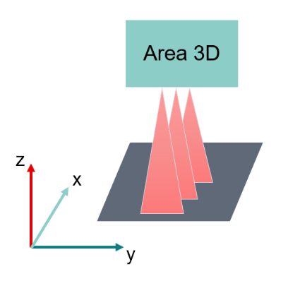

Use Case 3: Area 3D Compact Sensors
Area-based 3D sensors typically provide height maps along with resolution value for the x, y, and z dimensions or even pre-calibrated point clouds. The resolution factors can be applied in CVB as described in the section Static Factors for ZMaps.
