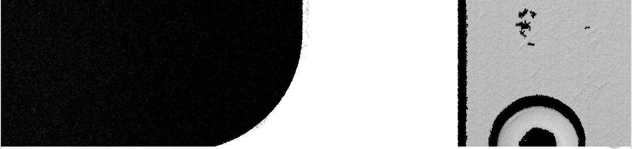

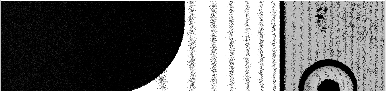

Gap Filling for ZMaps
After rectifying a calibrated point cloud, the resulting ZMap may contain small gaps. These gaps can be filled using the Cvb::FillGaps function, which applies linear interpolation, as shown in the example below:
#include <cvb/range_map.hpp>
auto zmap = ...;
auto options = Cvb::GapFillingOptions(0.0, 100, 100, Cvb::GapFillingMethod::LinearInterpolation);
Cvb::FillGaps(zmap->Plane(0), options);
void FillGaps(const ImagePlane &rangeMap, const GapFillingOptions &options)
var zmap = ...;
var options = new Cvb.GapFillingOptions(0.0, 100, 100, Cvb.GapFillingMethod.LinearInterpolation);
Cvb.Process.FillGaps(zmap.Planes[0], options);
zmap = ...
options = cvb.GapFillingOptions(0.0, 100, 100, cvb.GapFillingMethod.LinearInterpolation)
cvb.fill_gaps(zmap.planes[0], options)
None fill_gaps(cvb.ImagePlane range_map, cvb.GapFillingOptions options)
The resulting ZMap may then look like this:
zmap with gaps
ZMap with Gaps
zmap without gaps
ZMap without Gaps
