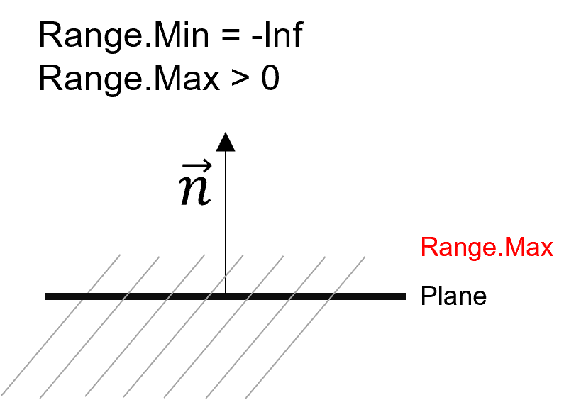

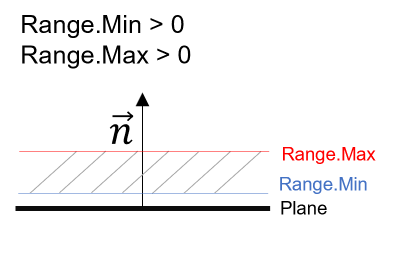

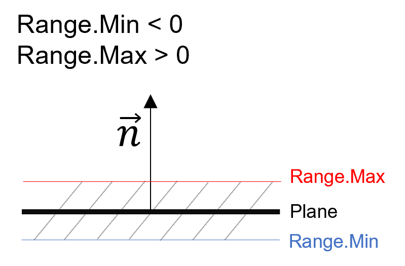

Creates a new point cloud where points within or outside a range parallel to given plane are cropped.

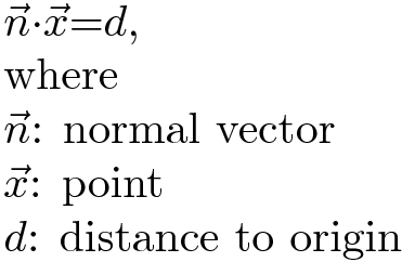

The plane is defined by the hessian normal form:
Points are cropped within or outside a range parallel to the given plane. The range is defined by range. Note, that Range.Max and Range.Min are applied along normal direction.
In order to define a range around the plane, maximum and minimum range have to be positive and negative respectively.
Note
Cropped points are set non-confident. Lines and columns at the borders containing only non-confident points are removed. If the input point cloud does not contain a confidence plane, a confidence plane will be added to the cropped point cloud.
plane : cvb.Plane3D Points parallel to this plane will be cropped.
range : cvb.NumberRange Points within or outside this range will be cropped.
crop_range : int Indicates whether points should be cropped within or outside the range.

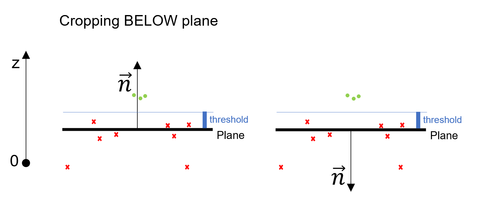

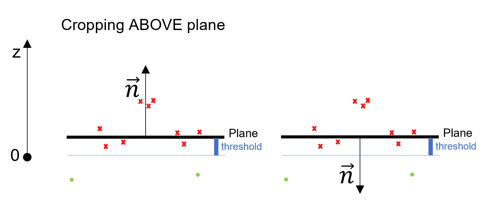

Creates a new point cloud which only consists of the points below or above given plane.
Above plane means all points with z values greater than the plane are cropped. It makes no difference in which direction the given normal points. The normal is always converted, so that it points up (positive z value). Note, if Normal.Z equals 0, 'below' and 'above' is undefined and thus no cropping is done. Instead the input point cloud will be duplicated.
Note
Points beyond the plane are set non-confident. Lines and columns at the borders containing only non-confident points are removed. If the input point cloud does not contain a confidence plane, a confidence plane will be added to the cropped point cloud.
plane : cvb.Plane3D Points beyond this plane will be cropped.
threshold : float Points below plane plus this value and points above plane minus this value are cropped respectively. This threshold should be set, if plane is calculated via fit_plane(). It ensures, that all points beyond this plane plus noise are cropped.
crop_below_above : Optional[int] Indicates if points should either be cropped below or above plane (optional, default value: cvb.CropDirection.Below).
