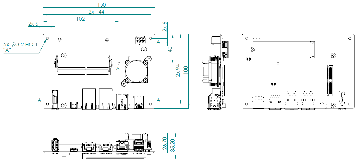

Physical Specifications
Dimensions 150 x 100 x 35.2 (w x l x h in mm)
Power 9 - 36 VDC
Operating temperature 0°C to +55°C
Conformity ROHS
Module Support NVIDIA Xavier NX
NVIDIA TX2 NX
NVIDIA Jetson Nano
Accessories heat sink, fan sink, power adapter

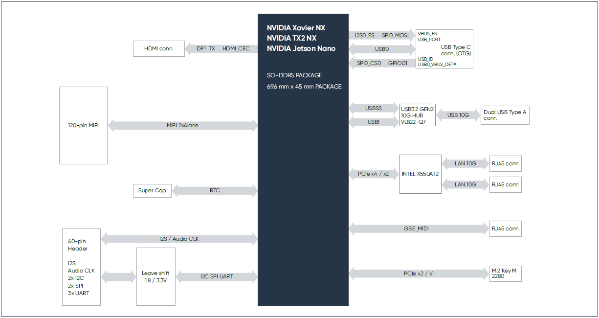

Block Diagram
