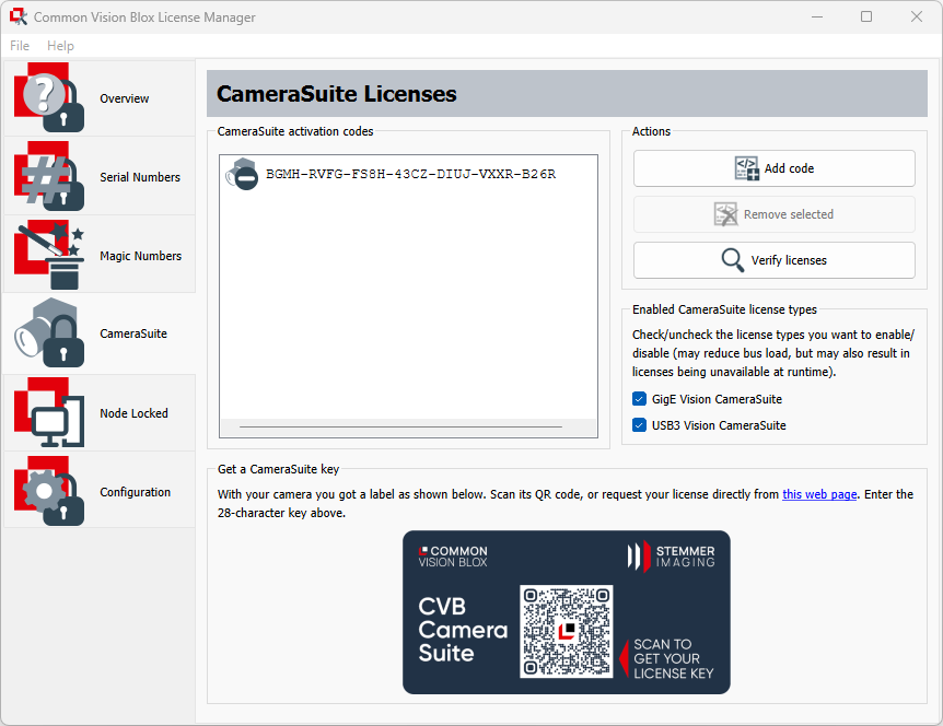

The "CameraSuite" tab of the LicenseManager lists all CameraSuite keys (shipped with eligible devices) that have been entered on the current system:
The icon next to each key indicates whether it refers to a GigE Vision or a USB3 Vision camera. In case of GigE Vision camera the icon will show a check mark if the camera is currently connected to the computer.

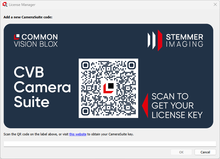

To enter a new CameraSuite key, press the button with the "+" sign on the right panel. This will open a dialog in which the key can be entered as printed on the label that came with the camera:
If the key was entered correctly the dialog will accept it and it will be added to the list of entered keys.
If the computer is connected to the internet and the CameraSuite-enabled camera(s) is/are connected to the computer, then the LicenseManager application can automatically query a database in the internet for CameraSuite keys for this/these camera(s) when started. If a key is found that has not yet been entered on the system, it will automatically be added to the collection.

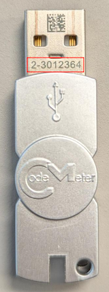

The USB dongle does not have to be activated. It will be automatically identified. Check the "Serial Numbers" and "Magic Numbers" tabs mentioned earlier to see if your dongle is detected. If it is not listed there, then please contact support.
The serial number of your CVB license can be found engraved on your USB dongle, in the form of "Y-XXXXXXX" where "Y" is the serial number type and "XXXXXXX" (7 digits) the CVB serial number. The engraved QR code can also be used to readout the whole serial number.

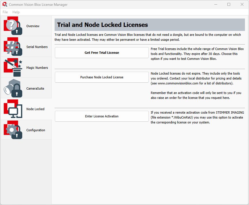

Acquiring and activating a Node Locked license or a Trial license follows the same routine: Simply press the appropriate button on the Node Locked page of the CVB License Manager:

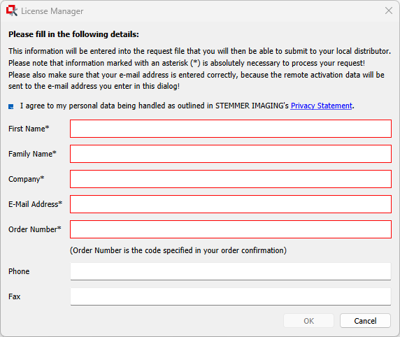

... then give your contact details (and, if you are requesting a regular Node Locked license, the order code of the product order to which this license refers):
Please save the request file (extension *.WiBuCmRaC) to disc and email it to: cvbli.nosp@m.cens.nosp@m.e@ste.nosp@m.mmer.nosp@m.-imag.nosp@m.ing..nosp@m.com. In return you will receive the license activation data file with the extension *.WiBuCmRaU, typically during the next few working days.
Once you have the activation data, return to the Node Locked page of the CVB License Manager and press the Enter License Activation button to activate your new license for Common Vision Blox.
