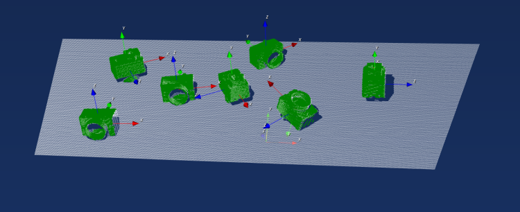

Each individual result in the result list contains information about the location and orientation of the object found, so the data can be used, for example, to guide a robot to the object.
A scene with objects to find. Sensor resolution is 640x480 pixels.
The scene with the found objects overlaid (processing time about 500 ms).
The same scene in much higher resolution of 1920x1080 pixels (processing time about 500 ms).
