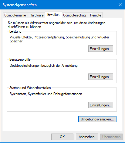

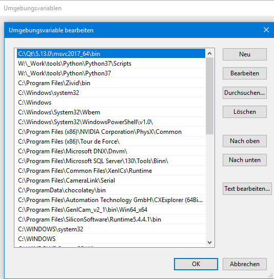

6Set the environment variable by adding G:\Qt\<version>\bin to the PATH variable:
- Windows-Key
+ R
- Type sysdm.cpl
- Set the PATH
