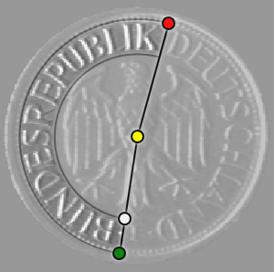

cvbbool_t CreatePolarImage (IMG ImageIn, double CenterX, double CenterY, double Alpha0, double InnerRadius, double OuterRadius, IMG &ImageOut)
 Creates a polar transformed image using linear interpolation from a full ring (360°). .
cvbbool_t CreatePolarImageEx (IMG ImageIn, double CenterX, double CenterY, double Alpha0, double AlphaTotal, double InnerRadius, double OuterRadius, IMG &ImageOut)
 Creates a polar transformed image using linear interpolation where the ring segment can be fully specified.

◆ CreatePolarImage()
cvbbool_t CreatePolarImage ( IMG ImageIn,
double CenterX,
double CenterY,
double Alpha0,
double InnerRadius,
double OuterRadius,
IMG & ImageOut )
This is a shorthand for CreatePolarImageEx with AlphaTotal = 360°:
CreatePolarImageEx(ImageIn, CenterX, CenterY, Alpha0, 360, InnerRadius, OuterRadius, ImageOut);
cvbbool_t CreatePolarImageEx(IMG ImageIn, double CenterX, double CenterY, double Alpha0, double AlphaTotal, double InnerRadius, double OuterRadius, IMG &ImageOut)
Creates a polar transformed image using linear interpolation where the ring segment can be fully spec...
Definition TransformationExports.cpp:892
Note
Call ReleaseObject on ImageOut, when it is no longer needed.
[in]ImageInImage object handle of the image to be transformed.
[in]CenterXPositive X coordinate of transformation center.
[in]CenterYPositive Y coordinate of transformation center.
[in]Alpha0Angle in degrees where to start the polar transformation.
In the image above (300×300) the parameters are roughly as follows:
CenterX, CenterY  150,150 (yellow point)
Alpha0   100° (line that ends with green point)
AlphaTotal   185° (line that ends with red point)
InnerRadius  80 (line segment from yellow to white point)
OuterRadius  120 (line segment from yellow to green or red point)
Angles are measured clockwise and an angle of 0° describes a line segment in direction of the positive x-axis. The AlphaTotal defines the length of the ring segment. Thus the line segment that ends with the red point has the absolute angle of Alpha0 + AlphaTotal.
The resulting dimensions of ImageOut, which is created via CreateCompatibleImage, are calculated as follows:
(OuterRadius and InnerRadius are inclusive)
