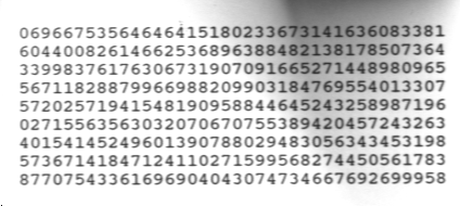

Performs dynamic thresholding on the input image.
Dynamic thresholding works such that for each pixel of the input image, the average gray-value over a mask with given size (centered around the pixel in question) is calculated.
If the difference between this average and the pixel that is currently being looked at is above the specified threshold, then the corresponding pixel in the output image is set to white, otherwise it is black.
This function is particularly useful when dealing with images that have a non-uniform illumination: Dynamic Threshold Test

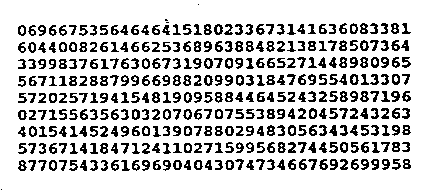

Normally it is possible to find a set of parameters (averaging window size and threshold), that yield approximately the same results for varying lighting situations. For example the image above binarized with a window size of 9 and a threshold of 10 look like this: Dynamic Threshold
Works on input images with up to 16 bits per pixel.
