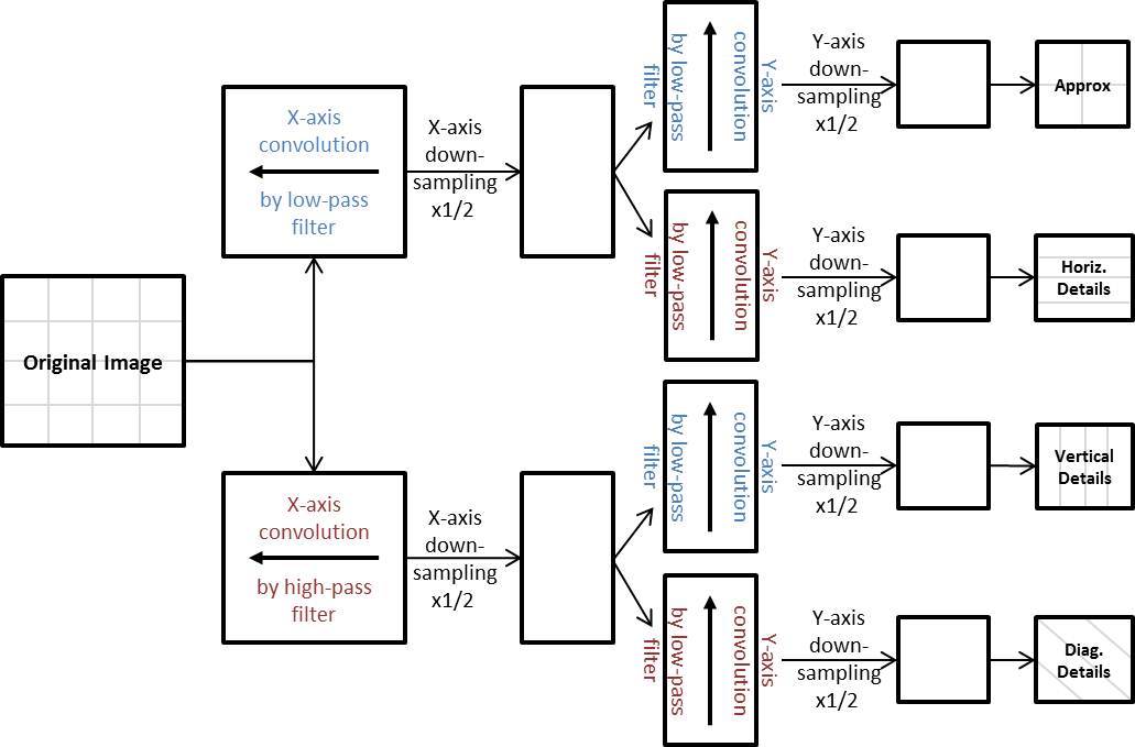

The forward/inverse wavelet transform use the fast polyphase algorithm which is equivalent to traditional application of separable convolution and dyadic resampling in different order. The following image shows the discrete wavelet decomposition:
Image: Intel Integrated Performance Primitives, Reference Manual, Volume 2: Image and Video Processing. Ipp 7.0
The decomposition components have following meaning:

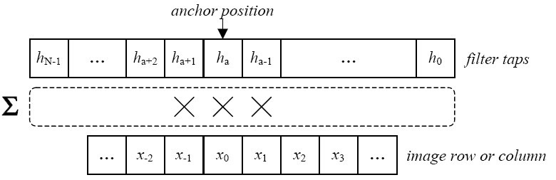

The filter bank consists of two analysis filters and includes the low-pass decomposition filter (or coarse filter) and the high-pass decomposition filter (or detail filter). The parameters AnchorLow and AnchorHigh describe the filter offset within the low-pass/high-pass filter. The anchor value sets the initial leftmost filter position
relative to image row or column as shown in the following image (where N is LengthFilter):

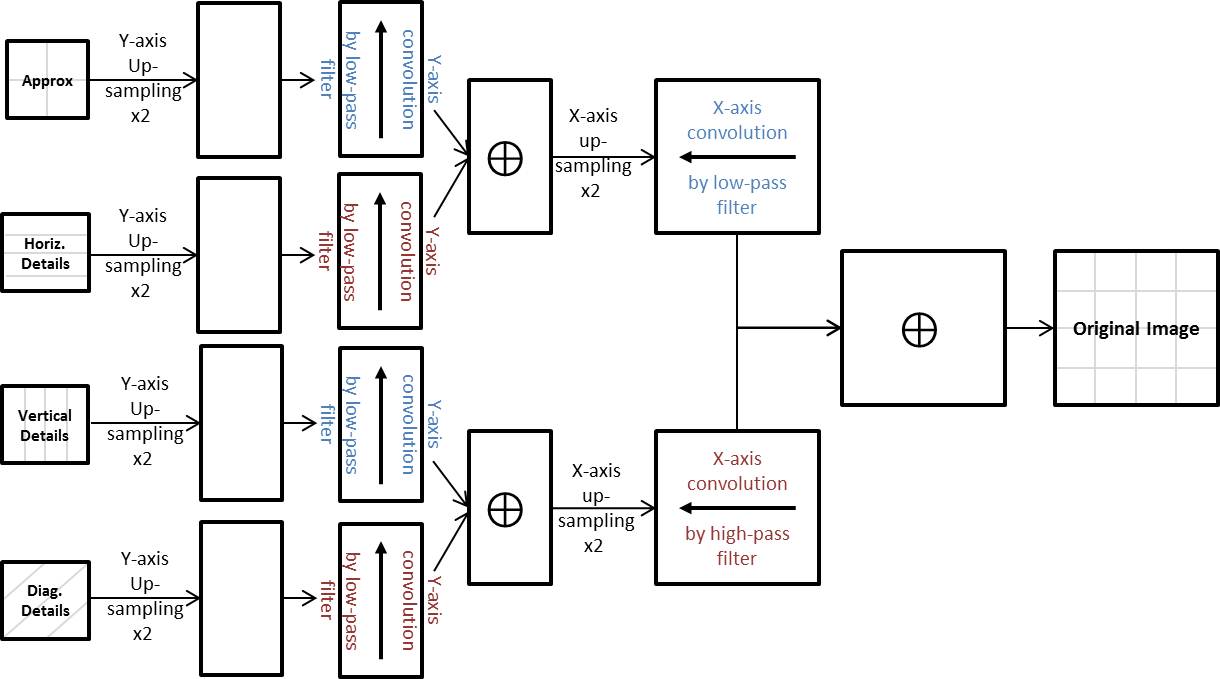

The following image shows the discrete wavelet reconstruction:
The filter bank consists of two synthesis filters and includes the low-pass reconstruction filter (or coarse filter) and the high-pass reconstruction filter (or detail filter). The parameters AnchorLow and AnchorHigh describe the filter offset within the low-pass/high-pass filter. The anchor value sets the initial leftmost filter position relative to image row or column as shown in the following image (where N is LengthFilter):
