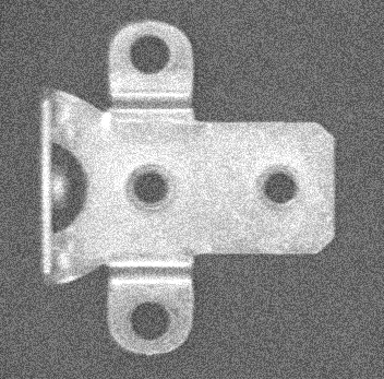

Add gaussian distributed noise to the image.
This function generates random noise with Gaussian distribution that has the mean value and standard deviation and adds it to a source image. The resulting pixel values that exceed the image data range are saturated to the respective data-range limits. To obtain an image which contains pure noise with Gaussian distribution, call AddGaussNoise using a source image with zero (black) data as input.
Sample: Image with added gaussian noise with mean = 32 and stddev = 32:
Bracket original
Bracket Gauss

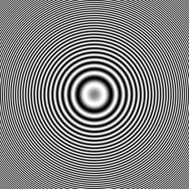

Creates an image with concentric circles with a frequency that increases as the radius of the circles increases.
Such an image may be useful to test the characteristics (especially the anisotropy) of an image filter:
Test filter image

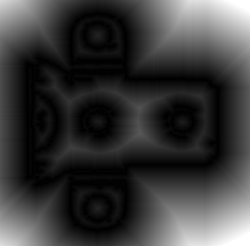

Calculates the distance to the closest pixel in the source image with value zero for all non-zero pixels in the input image.
The distance is calculated approximately using a set of principal distances that is governed by the MaskSize parameter and the distance norm. \n\n

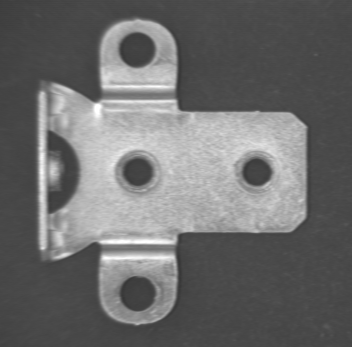

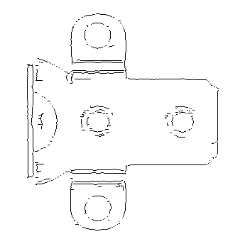

Example: Distance transformation on Bracket.bmp.
To get a suitable input image for the distance transformation, the inverse of the canny edge filter image is used:
<table border="0">
<tr> <td> <img class="ToDisplay" src="Bracket.gif" align="left"  alt="Bracket original"> </td>
Bracket Canny Negative
Bracket Distance
Input image
Inverse of Canny edge filtered image
Distance transformation with L2 norm and 3x3 mask

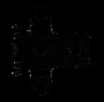

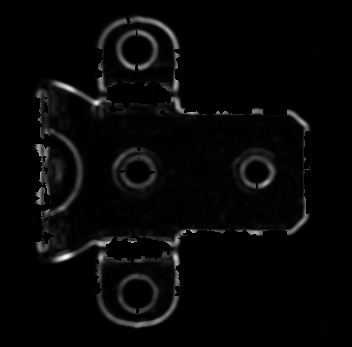

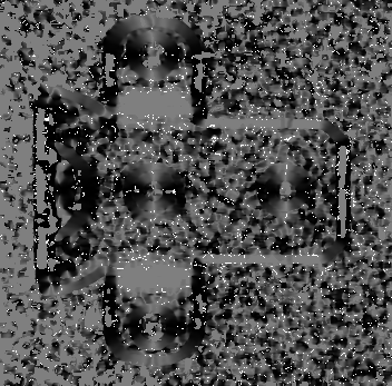

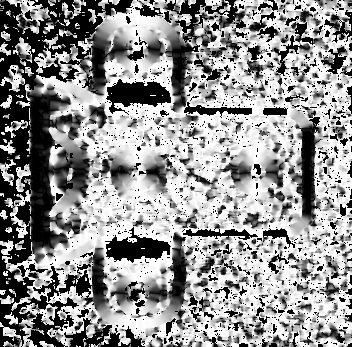

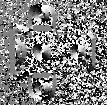

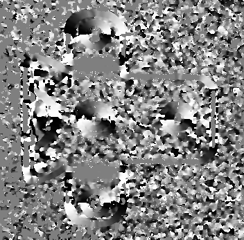

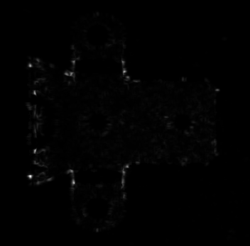

Computes, for every pixel in the input image, both eigen vectors and eigen values of the matrix
Eigen matrix
D stands for the derivative operator (it is the Sobel operator that is applied internally here) in x or y direction. Summation occurs over the blur window around a pixel. The output is a set of 6 floating-point images, containing the two eigen values (not sorted by size) and the associated eigen vectors for each pixel of the input image. In cases where the matrix is singular or when one eigen value is much bigger than the other, all 6 output values are set to zero.
This kind of operation is useful when it comes to detecting e. g. curvatures in the image, because the eigen values tend to differ significantly from zero only in regions where the are curved edges. Perfectly straight edges or random noise will result in eigen values close to zero.
Bracket original
Input image
Eigenvalues 1
Vect1X
Vect1Y
Eigen Value 1 Eigen Vector 1, X component Eigen Vector 1, Y component
Eigenvalues 2
Vect2X
Vect2Y
Eigen Value 2 Eigen Vector 2, X component Eigen Vector 2, Y component

[out]ImgEV1XX-component of the eigen vector associated with the first eigen value for each pixel of the input image.
Attention: Note that the pixel format is floating point.
[out]ImgEV1YY-component of the eigen vector associated with the first eigen value for each pixel of the input image.
[out]ImgEV2XX-component of the eigen vector associated with the second eigen value for each pixel of the input image.
[out]ImgEV2YY-component of the eigen vector associated with the second eigen value for each pixel of the input image.

Computes, for every pixel in the input image the minimum eigen vector of the matrix
Eigen matrix
D stands for the derivative operator (it is the Sobel operator that is applied internally here) in x or y direction. Summation occurs over the blur window around a pixel. The output is a floating-point image, containing the smallest of the two eigen values for each pixel of the input image.
Bracket original
Minimum eigen value
Input image Minimum Eigen Values
[in]ImgInHandle of image object.
[in]IndexPlane index to work on.
[in]DerivatorSizeSize of the kernel of the Sobel operator to be used for the derivation operations internally. Allowable values are FM_3x3, FM_5x5 .
[in]BlurSizeMask size for blurring/summation. Allowable values are FM_3x3, FM_5x5 .
[out]ImgLambdaMinMinimum eigen values for each pixel of the input image.
