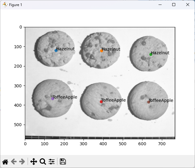

In this example, we assume that classifiers have already been created and apply them to test images. The aim is to find all cookies in an image and then assign them to a cookie type. The two classifiers used are Cookies.psc (psc for polimago search classifier) and CookieType.pcc (pcc for polimago classification classifier). They can be found together with the image files and the TeachBench project files in the Polimago/Images/Cookies directory (%cvb%/Tutorial/Polimago/Images/Cookies) within the Common Vision Blox Tutorial folder.

search_res, _ = search_clf.grid_search(testimage, testimage.bounds, grid_step=0.5, threshold=0.0, locality=1.0)
plt.imshow(cvb.as_array(testimage), 'grey')
for res in search_res:
if res.quality >= 0.3:
# Classify a found cookie
pos = cvb.Point2D(res.x, res.y)
clf_res, _ = classify_clf.classify (testimage, pos)
plt.scatter(res.x, res.y)
plt.text (res.x, res.y, clf_res.name)
plt.show()

The above python code will produce the following image
The classified cookies.
